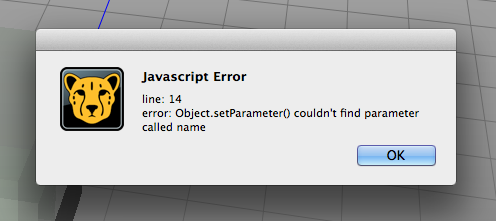

This great script does not work on Cheetah 3D 6.2
Hiroto, I'd love to have access to use this script - but it fails under Cheetah 3D 6.2 - would you consider updating it?
Thank you.
attachment.php
Sorry to say - but it still works as it is. ;)
And there´s still particle-spline which may do also for what you want.
hi, thank you for trying my script.
It works as expected on my mac. so, Please check installed folder for that script again ( it's polygon script, so ~/Library/Application Support/Cheetah3D/Scripts/Polygonobj is a right folder).
anyway, your problem was solved with another script, wasn't it?
regards.
tg_jp, Hiroto.
Yes, I solved the challenge with another script.
But thank you anyway - very much. Your contributions and help are very valuable, and very appreciated.
