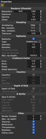

Sigh, back again with this issue... this weird glitchy green noise when saving out as ProRes 422 (or really anything OTHER than H264) See the attached screen grab. Its doing something with the whites... color gamut? The hard part about saving as H264 is that the color then shifts and doesnt match the next :10 sequence. (of previously rendered ProRes movie)
Helmut, you mentioned something about the Render Panel (attached screen grab) is there a secret button at work here? Really becoming a road block here with my older rendered files.
Hardware: Mac Studio M2 Ultra with 24‑core CPU, 60‑core GPU, Sonoma 14.5

Have you checked if the PNG-stills show the green artefact already? Go HD/Users/You/Library/Application Support/Cheetah3d/Render History/....
Oh yes - I use those for my storyboards. (PNG Render Still) work perfect. Thats when the alarm bells triggered - when it was time to begin the renders. (Apple ProRes 444)
This folder is interesting.... yep - those PNGs are fine. Awesome.
So what happens here? it renders the single frame PNG and then compiles into the movie?
Hmm... not a great work-flow but I can use these Stills. I will give it a try. THANKS!
((fer sure would like to use my new box - way speedier render times))
Cheetah3d stores animations as PNG image sequences no matter what video-codec you want to use in the end; so macOS generates a video container based on the image sequence under specific compression specifications. And that's probably the crux of the matter. And funny or rather strange is that ProRes and QuickTime are Apple products, but Quicktime cannot display transparencies at all.
