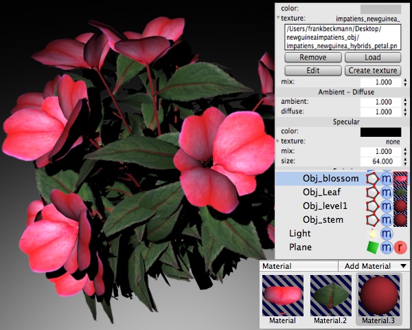

So I had a go with a sample of a downloaded xfrog-plant for non-commercial use.
For some reason it wonīt load the textures. I created the three materials manually (set specular to black; 0,0,0 and donīt forget to activate the alpha-channel for the .png; so you wonīt see the rest of the leaves`mesh) and throw them in, where I thought they might belong to and what could I say; Not too bad.
Than I tried the same plant with another downloaded format:. 3ds. Made a doubleclick and voilá: surprise, surprise. There it was, with all textures assigned, specular off, alpha on upright standing.
Very strange.
So thatīs my state of view now. I hope the guys from Greenworks can help you out, so that your investment wonīt be lost.
