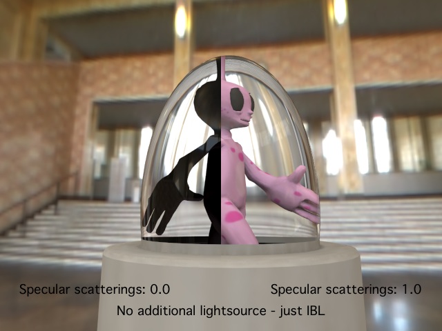

Posts: 9,820
Default 09.05.2009, 19:01
Just set the amount of specular scatterings to at least 1.0. in the radiosity tag.

Posts: 7,407
Default 10.05.2009, 14:30
Hi Terry,
you can also attach a "Render Tag" to the glas cover and disable "visible in radiosity". That will rendere a little bit faster then increasing the specular scatterings in the "Radiosity" tag.
