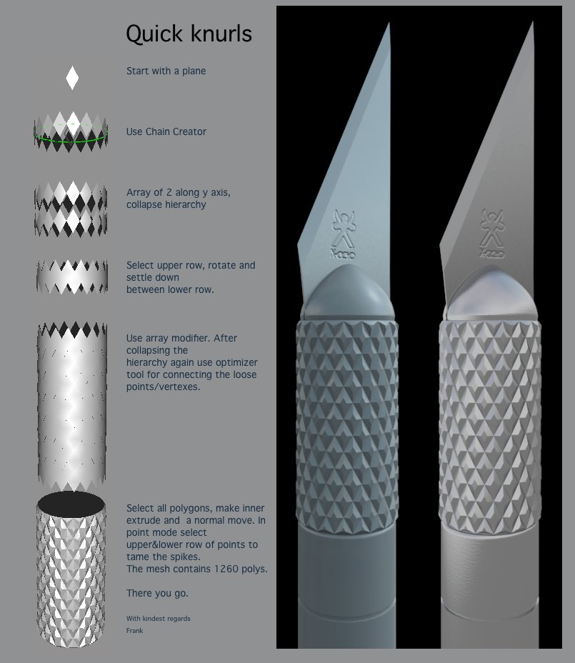

Default Quick Knurls Anyone? - 30.03.2008, 15:39
Hi.
Have fun.

Lächeln Very nice Frank. - 30.03.2008, 17:05
Thanks Frank, I enjoy learning from your examples. again this will be useful. Thanks

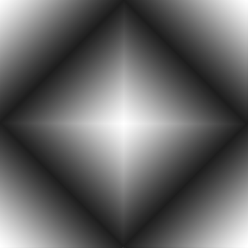

Default Knurl with bump map - 30.03.2008, 17:40
I managed to get a knurl I was happy with using a bump map, which you can see in the upper image below.
I set the bump map to to tile in U and V on the material. I used a bump intensity of 5.0. I played with the UV scale, using X=20, Y=5 to set the scale of the knurl.
The final result is at the bottom. Not bad for my first Cheetah3D model!
