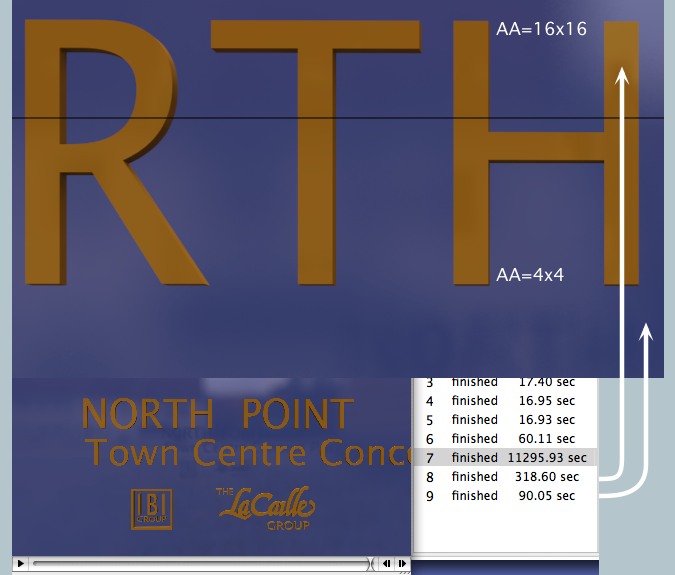

I´m not a techi, so maybe I look from a different angle at the points you´re mentioned. Nevertheless I grab your file. There are a few killer settings in I would never ever use: Antialiasing at 16x16 and of course the size. I corrected some settings to my "normals" alongside some changes in the geometrie/spline/extrude settings. I activated HDRI, the background plane with the angle reflective material and AO, but turn off the light. The rendering took 11295sec on my Intel iMac´06 and it looks awesome, but is not playable at this 2560x1440 size. (For what kind of purpose is that huge output?)
What else can I say? (Other than the text is a bit out of focus at the end of the animation )

Thanks Frank for playing around with this model, too. Why would the text be out of focus at the end? Is there anything I can do to fix that?

Posts: 9,820
Default 22.02.2008, 14:36
Hi Chuck.
I didn´t edit the timeline so in the image above you can see the last frame and all you can read is "Town Centre Conc.......". So the rest never reaches the main focus of the camera.
