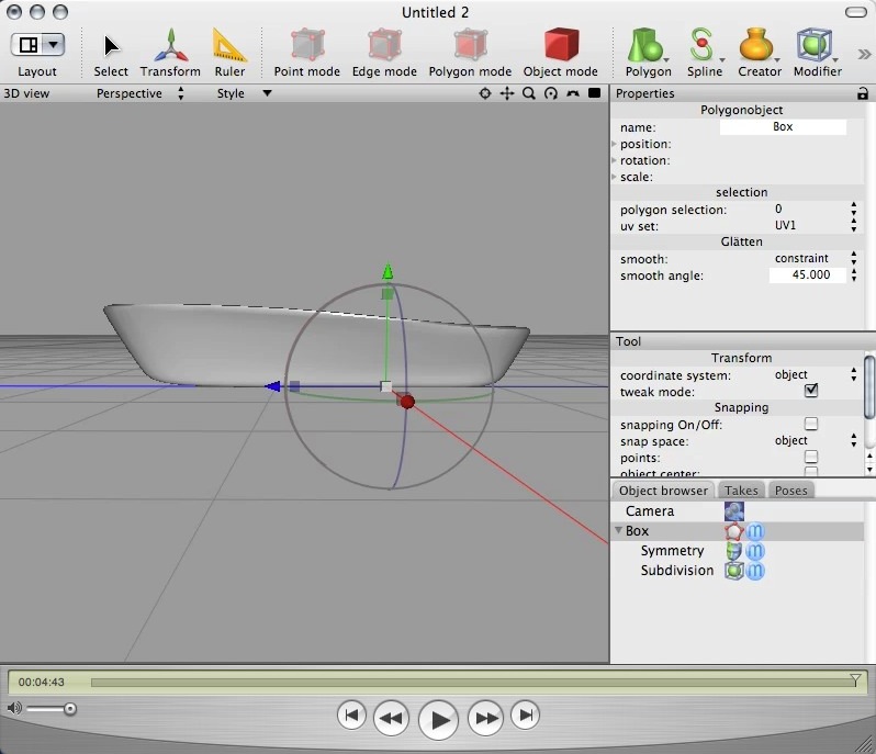

Hereīs a 5MB video of about 5min starting up the boat via boxmodelling.
I can send it by request.

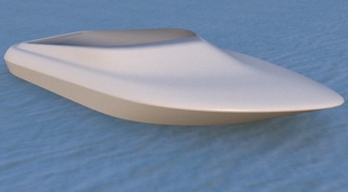

Thanks- I think I figured it out with your loft.js script. Will come in handy in the future. Just wish you could control the divisions in one direction. Here is the finished result- finished enough to move it along to another program. It is only a conceptual model of a boat to be used in an even larger model of a boat show room and trade show.
Thanks again for the help.

I am an extreme noob, having just d/l'd C3D to see if I can learn it to model a boat. So far, I don't seem to be able to do much of anything, but I am sure that watching a video would be a huge help. Can you email that to me? I think I have enabled my account to allow emails to be sent.
Thanks,
- Gardner
Originally Posted by frank beckmann View Post
Hi.
No wait, man. You donīt have to write a script. Thereīs already a loft-script in the scripting section you can use, when you like to use splines for that: http://www.cheetah3d.de/forum/showthread.php?t=1327
Further help needed?
Posts: 9,815
Default 08.04.2008, 18:27
Hi.
Video is on its way.
