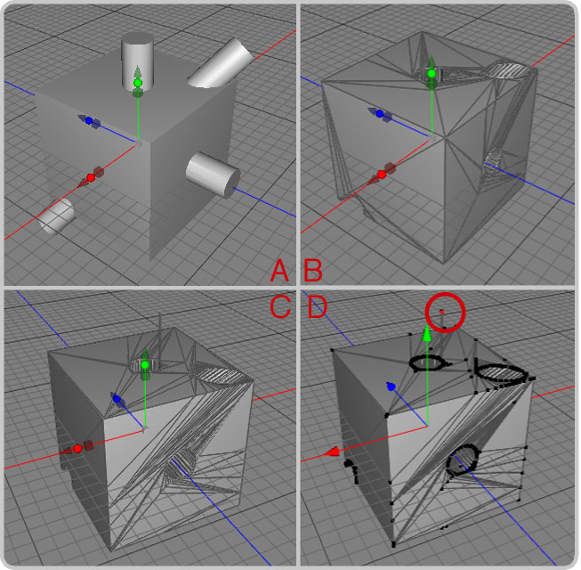

(Hi Enoch Aryee.
I discovered, that it can be useful to boole (connect) the holes (drills) first.
For Example: Boolean tool set to "A uniting B", put in two cylinders and doubleclick the result (the boolean tool), so that it will be transformed in a single mesh. Again choose boolean tool, set to "A+B"; throw in first boolean mesh and the last cylinder. Doubleclick the tool. Now all your drills are connected to one piece. Choose once again the boolean tool; set "A minusB). Throw in your meshed holes first, than the thing you want it divided from (excuse my english, please)
Done.
This method comes with a reward of less polygons in the resulting mesh. (See row A to B). In this case 4688 polygons (all triangled) instead of 5291. Dividing one by one, will end sometimes in unexpected output. (See row C and D; red circle)
Hope this was not too academic.
bye frank 8) )

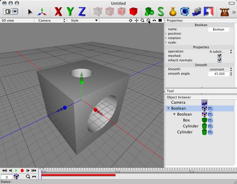

the boolean creator object only substratcs on object at once. If you want to substract two cylinders for example you have to make something like the on the attached screenshot.
First substract one cylinder from the box. Than take the result from the boolean creator object and substract the other cylinder from it.
But I should probably change that behaviour so that it is possible to substract more than one object at once.
