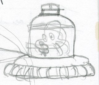

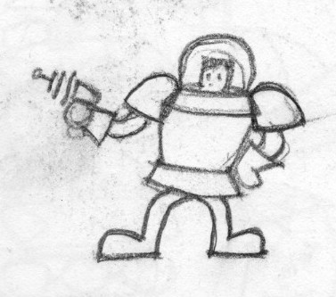

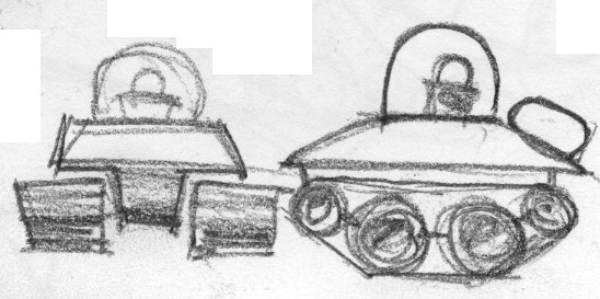

If you really want to impress me, send me a model or test animation of a 3d figure based on one or more of the attached sketches (yes they're terrible!). Try to stay below 10,000 polygons (triangles, not quads) -- although you can use more for hero renders of course.
Notes on the Sketches
Moon buggy is with or without operator. If you add an operator, that's not part of your polygon budget.
Guy in spacesuit should have a reasonably cute face etc -- not a blank sphere with dots for eyes, anyway.
And yes, that's a Septopus at the controls of a small hovercraft inside a water-filled dome.

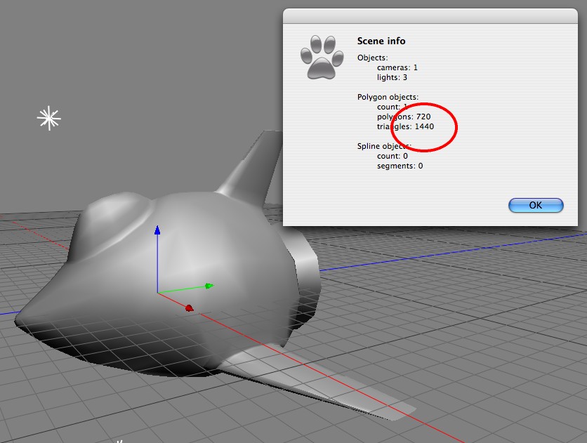

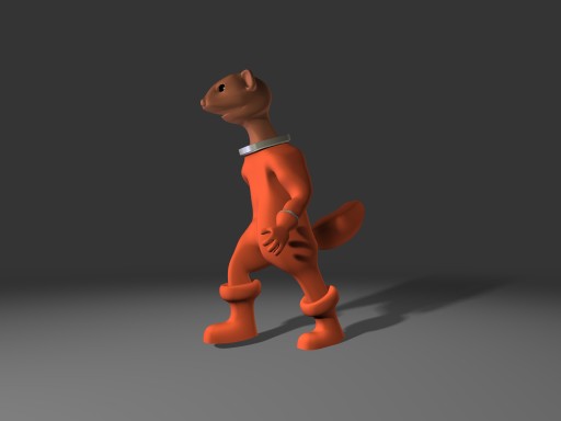

I have a style in mind. It should be fairly obvious from the sketches that I do not want "ultra-realistic steroid swilling grotesquely muscled neckless grunts with bandanas" ... this is a kind of whimsical kid-friendly game that will appeal to both casual and hardish core gamers, and adults. Think: The Incredibles or the Wii game Rayman: Raving Rabbids (closer to the former than the latter). I've attached some existing assets from the game -- an unrigged slime creature, an earthlike planet, my weasel , and the weasel's rocket plane (they're all in different states of incompleteness).

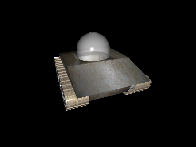

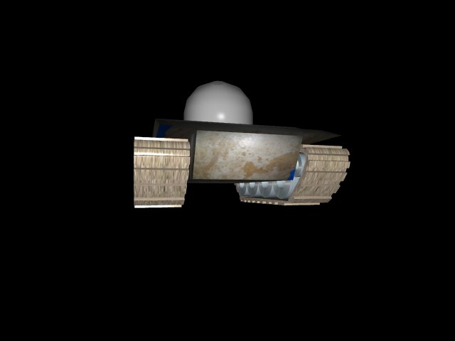

Here is the moon buggy I modelled. It obviously needs alot of work, but it's my start!

Posts: 4,555
Default 13.05.2007, 00:02
hairball600
Thanks for your effort.
This makes me realise that, because many folks here don't do realtime applications, I need to give a better idea of what the requirements are for game and other realtime applications.
Polygon Count
The polygon budget is very very serious. And we're talking about the budget for the final geometry, not the budget for some rough shell that you plan to add a ton of detail to later. (There is a place for high-definition geometry in realtime applications, but that's another story.)
Note that hairball's model is only ~5200 triangles, but that's with no real detail in the hull. Most of the polys are, frankly, wasted on the wheels and tracks.
Animation
One thing you need to think about is how would this be animated? There are two obvious ways to animate tracks. One would be to use the chain creator to make a series of links along a path and then animate them moving along the path. Another would be to build a fixed object with simple geometry and animate its texture (and possibly distort it a bit). Using a highly detailed sweep uses a ton of polygons and gives you no real option for animation. (In general, sweeps are not going to be your friend for realtime work.)
Texturing
I would also get the model pretty much right before I did anything with textures. Half-baked (no pun intended) textures are worse than no textures at all... and for realtime applications a model generally needs to use exactly one material. (This is because realtime rendering is done object-by-object and texture-by-texture ... if an object uses three textures, it takes three passes to render it; if you have 100 guys running around and each is built out of several textures ... ouch.) This means UV-unwrapping the model carefully and then painting on the result directly. This means building separate color, bump, specular, transparency, and emission maps if required. In any event, doing a good job of UV-unwrapping is the hard part, not assigning textures.
I hope this helps.
