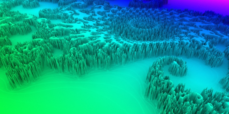

I would like to announce Fracton, a free Mac only application for generating high quality fractal models that are compatible with C3D. Fracton generates height field models that look a bit like terrain. Here is an image of a model generated by Fracton and rendered in C3D.

I took a different approach on exporting models from Fracton. It exports an OBJ file of an optimal model using the least triangles it can. I wanted to have something so accurate you could move right up to the model and still have it look good. If you export height values in a grid even in 16 bit you get something like this:
Sure, you can increase the resolution of the grid but still when you get close you will still see the jaggies. What I did in Fracton was make polygons out of contour lines that are fit to the fractal iteration bands, not to a grid. That looks much better. More like this:
Fracton calculates more points along the edge of the polygon when the edge is curvy and less when it is straight. In this screenshot from C3D you can see the model has more points in the curvy parts and less where it is straight:
That makes the model much smaller. There is actually a lot more involved with the process than I mentioned here. I should also say that it is hard to get a perfect model and the process usually involves a compromise with how long you are willing to wait and how big a model you are willing to accept.

This image of a 3D model from Fracton, shows you can zoom in close and still have good quality. I also made a Quicktime animation (10 sec, 9.6 Mb) that flies down the valley. The image and animation were rendered in C3D.
It took Fracton 57 hours to make the model on my 2 core PowerPC Mac Pro. The animation took about an hour to render in C3D on my 8 core Intel Mac Pro. The original fractal is by Jim Muth and is from his Fractal Of The Day series. Jim's web page of the fractal is here.
