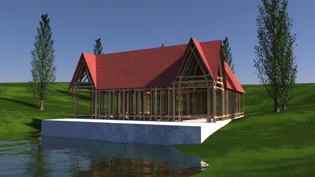

I have not yet finished a postable result, below is the standard *lombardy popular*, suitable for sketchy type scenes.
The leaves are exported in a separate object, so you can tweak them with normal scale etc. or triangulate squares and crumple for bent leaves.
Contributions appreciated !

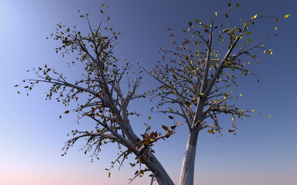

Thanks Alessandro,
this thing is really really promising.
It depends on the texturing skills, how close you can get...
second2.xml.zip

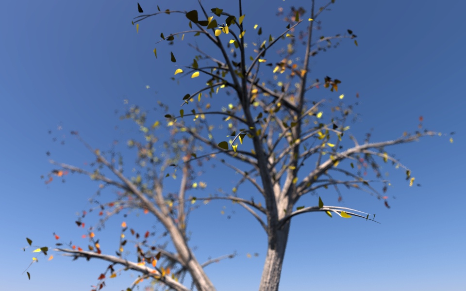

I'm totally in love with this little app!
After 24 hrs already some neat results,
so big thanks to WmH !

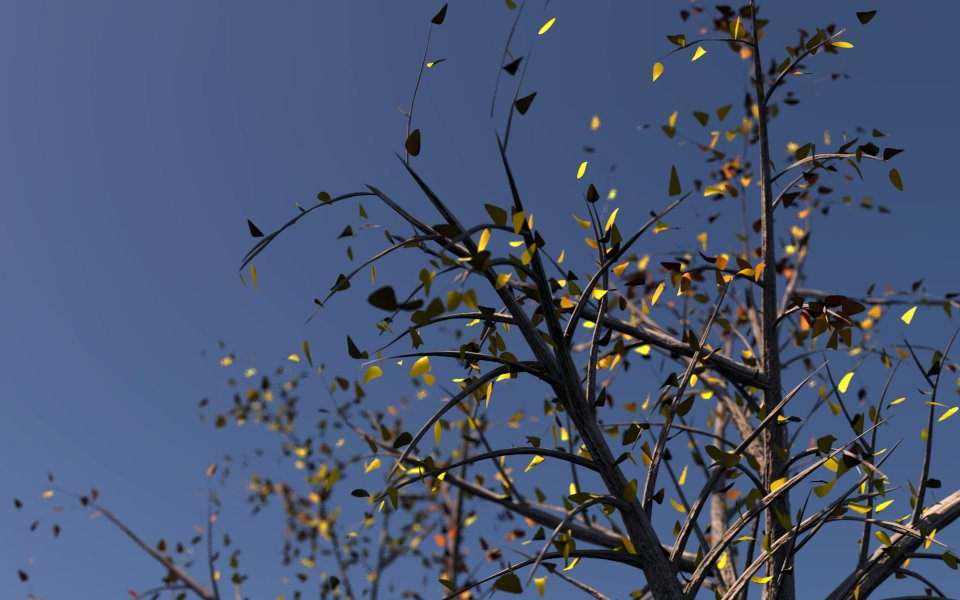

Really nice. I like the depth of field effect too. How did you do that?

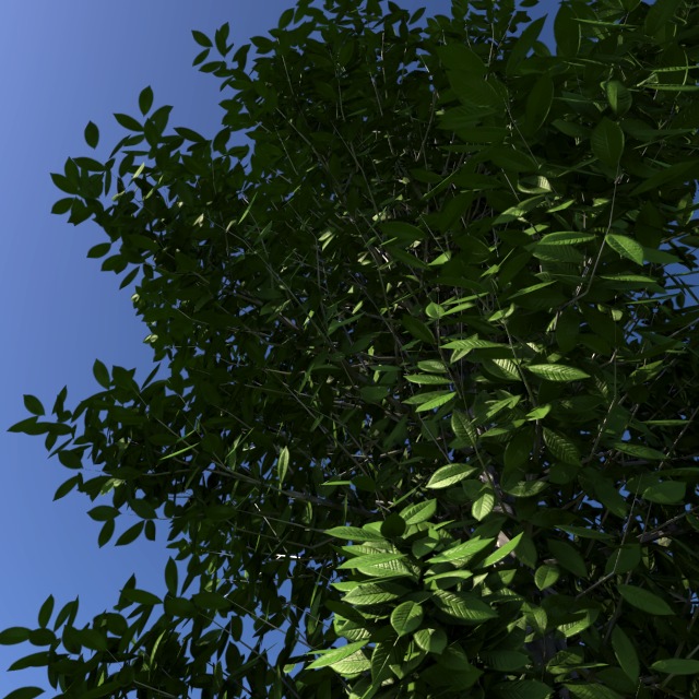

The bark is not yet finished, but for the leaves I made a neat bumpmap in order to achieve really prohibitive render times.
And it works !
Only I don't like it cause the things are not bent, but for leaf bending I need more than one quad.
Maybe I do an unbumped texture on a once subdivided and crumpled triangle or whatever.
Size:  18.9 KB Name:  LeafSpc.png
Size:  584 Bytes Name:  LeafTnp.png
Hi Jon, thanks for stopping by;
there is a Depht Of Field tag in Cheetah that does the trick !
